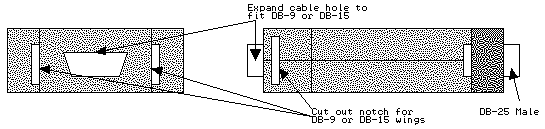

Here's how I have my interface hood set up, using a slightly modified plastic DB-25 hood:
Interface picture
I recommend not cutting up your joystick cables to make these interfaces. Instead, use the appropriate female or male connector so that you can connect any compatible joystick to the one interface. It is very easy to find the HD-15 and DB-9 connectors necessary for the Jaguar and Atari interfaces, but finding SNES connectors are probably impossible. For the SNES interface I recommend purchasing a SNES joypad extension cable and cutting off one end to wire directly to the schematic.
