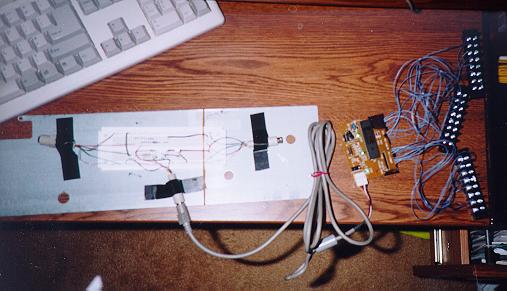

Since all the logic and communicating with the PC is done from the 2" by 3" circuit board, that's all I need from the keyboard for my system. The rest of the keyboard is just the mechanical part - and that's what I will be replacing with my own arcade buttons and controls. If you take a good look at the horrible picture that I'm replacing soon of the circuit board, you'll see a line of silver solder points about midway down the board, parallel to the copper contacts at the bottom. Each copper contact leads directly to one of these solder points. These solder points then lead to the keyboard controller chip. To interface my custom controls to the circuit board, I will solder wires from the solder points on the board to a set of quick connect terminal blocks (purchased from Radio Shack for a few bucks). See the picture here - note, this shows the other side of the circuit board, with the solder points down. I could solder wires direct from my arcade controls to the keyboard circuit board, but what if I wanted to change the layout later, or if I wanted two buttons for the same control (left and right handed fire buttons for instance)? I'd either have to unsolder and resolder or have multiple wires to the same solder point, etc. Very messy. Using quick connect blocks, I can redesign the controls without touching a soldering iron again. Highly recommended.
The next step is to map out the keyboard matrix. Connecting a wire from one contact to another contact on the circuit board is what generates a signal to the keyboard controller chip, which then generates a key to send to the computer. A simple matter of experimentation soon led me to having it mapped out. On my keyboard circuit board, there were 16 contacts on the left, and 8 on the right. Connecting a point from the left to one on the right generated a keypress. Connecting two points on the left, or two on the right, generated nothing. This let me map out a grid of 16 by 8 and then fill in the various keys produced by connecting contact points. I took a piece of wire, and soldered an aligator clip to it. I then clamped it to the first of the 16 contact points, and then one at a time, touched it to each of the 8 right hand contact points to see what happened. It looked like this. Notice the re-attached keyboard cable. I started my computer with the non-hacked keyboard, then unplugged it, and plugged in the circuit board to test with.
Because not every keystroke produces a visible effect, you will need some kind of keyboard testing program. When it detects a keypress it flashes it on the screen. Mine was a commercial package we use at work, but there is a free one made by David available for download here.
Finally, once I had the circuit board soldered to the quick connect blocks, and had the keyboard matrix mapped out, I put together a "beta" control system. I built Stephan Hans' keyboard splitter circuit on a breadboard from Radioshack. I attached the keyboard cable from the circuit board to one of the inputs on the keyboard splitter, attached a full keyboard to the other input, and ran an extension cable from the splitter output to the computer. Fired the whole thing up, and verified that the full keyboard worked, and that by connecting wires on the quick connect blocks I was also able to produce keyboard signals. The whole thing is mounted on a piece of wood until I know how I'm going to build my final project. Hopefully, from this to actually wiring buttons to the quick connect blocks should be a no brainer. Picture.
