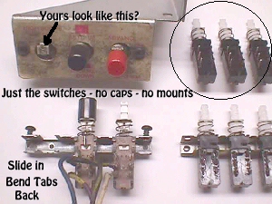

    - Broken WMs Service Switches-
    If you've got broken service switches... sheared off, sticking, poor contacts or whatever... on your Defender, or other Williams games, you can replace the switches individually to restore them. All you need to do is gently pry the four tines that hold them in place up to a horizontal position & slide the broken switch out & insert a new one. Bend the holding tines back enough to keep it steadfastly in place & transfer your wires to the same positions on the new switch as they were on the old & you're back in business again.
    I have replacement switches on the Parts Page at $2 each, but you'll have to use your old red or black button caps & these new switches do NOT replace the later WMs type that used white switches with poles on one side only.

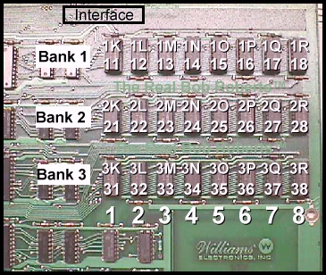

    - Williams Ram Layout Chart -
