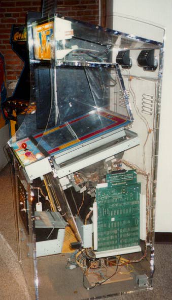

Finally, Here's a picture of my dream cabinet! :)
