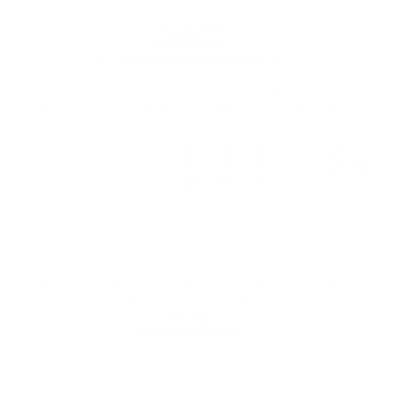

11/15/98 - The SNESKey Page is Back with: Playstation
Controller Support
The manual hasn't been updated yet, but an example
ini file is included in the Examples directory and the adapter schematic
is below. Replace the "X" in the schematic with a 10. Only the DOS version
supports the Playstation controller. The driver will be added to the Windows9X
version soon. Special thanks to Cheng Ka Chun of Hong Kong who sent me
a PSX controller, Juan Berrocal who sent me the code I based the SNESKey
driver on and who sent me some good info on the PSX controllers, and Justin
Bell who did the beta testing for me. The download is available below.

Just How Complex are These Circuits?
The circuits are just some wire, connectors, and
(optionally) some diodes. For complete circuits for SNES, NES, Genesis
and the rest see the SNESKey documentation.
