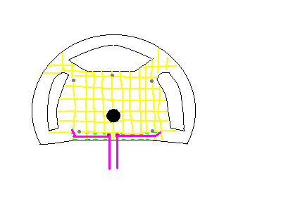

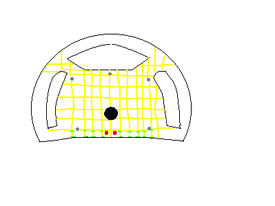

Upon inspection of the case you'll see its little "reinforcements" running like a little grid all about 2mm thick that stick out about 1/4" from the whole of the plastic (see the pictures below) you'll want to run your cables along the bottom row of these going both ways (right and left) (one for each cable) and cut the little plastic "barriers" to press the cables into place. Before attempting to install your cable you must first drill 2 holes less than a inch below the mount for the base about 3/4" apart. Use drill bits just slightly smaller than the cables and remember that the only drilling I've refered to so far should be in the back of the wheel casing. If you are attepting this you will find that each hole will end up being in the middle of the the "grid" squares. This whole grid thing may sound confusing but I ensure that if you do try this you will clearly see what I am talking about, it is very simple and I was shocked at how well, easy, and professional it all went together and looked when it was done.
Cut out the barriers just enough for the cables to press in nice and tight and then press down real hard on then and fill in each little section with hot glue ( there should be about 4 little sections on each side.). You want the cable to come around the screw posts and what I mean is thats about where the striped part should begin at(see picture above), you want the ends of the casing to stop just past where the screws go leaving about 2 1/2" of just the little wires(the ones you striped) extending up into the center of the controller. Once you've hot glued the cable into place you dont have to worry again about that cable coming loose making it safe enough to use mere small cut pieces of electrical tape to connect all the wires. Remember that ALL work mentioned so far has been for the back side of the wheel only. As you connect the wires make a chart showing what colors go to which so you dont forget later on and screw the whole thing up. Now squeeze each taped end to ensure that nothing is loose and double check everything and then carefully place the 2 fire buttons back in place and make sure no little wires are hanging out as you put the case back together. Now strip the ends of the other 2 Macintosh cables and connect them to the proper wires on the wiring harness following your little chart and mark each cable as being "1" and "2".

the yellow lines are the "grid", the grey dots are the screw posts, the black dot is the mount, the red dots are the drill holes, the green dashes are where you cut
the purple lines are the cables,where they end is just where the casing covered part of the wire ends and then the 2 1/2" of striped wires go on past that.
