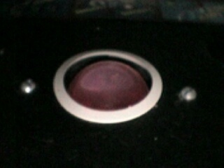

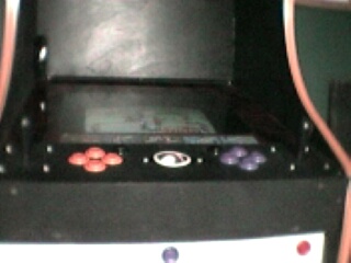

This is my quick and easy-no fuss way to mount a trackball. The Track ball I used is a Crystal Track ball from CompUSA. They're Cheap and they glow red and green.

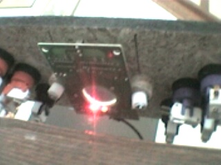

The board for the track ball is about 5” long and 3 ½ inches wide. The ball ‘rests’ on the rollers for the PCB’s.

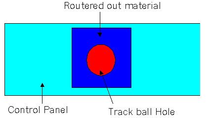

You have a couple of choices now - you can drill the hole for the ball and then on the underside of the control panel route out around the hole to provide the reveal you want (how much of the ball sticks out on the control panel) . . .
NOTE THAT ALL FIGURES ARE NOT TO SCALE
This is NOT the method I chose, for one I don’t own a router even though they are relativly cheap to buy they get yah on those router bits. The bits can cost forty bucks and up. A little steep for a one time thing.

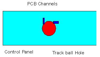

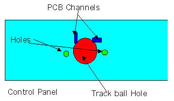

So what I did was simple and painless. I took my drill and I cut slots out for the wheels of my pcb’s to turn freely.
These only need to be about ¾” long and a ¼” deep. I accomplish this with a big drill bit and a file. I drilled 4 holes as close together as possible and then filed out the channel. After you have your channels in you may have to chip and dig at these channels a little more once you assemble everything.

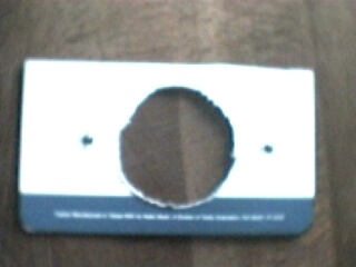

Now Drill two holes about 2 ½ “ from the Center of the trackball hole.
My figure doesn’t really show but the holes should be in a straight line.

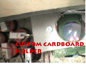

![]() (Note the two White pieces of plastic are and were only temporary) |
I know some of you are saying cardboard? Trust me - I have a 10 year old nephew and an 8 year old niece who BEAT this trackball and I swear it works great.

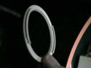

Oh, don’t forget to put your ring on (figure 1) and your all done.
