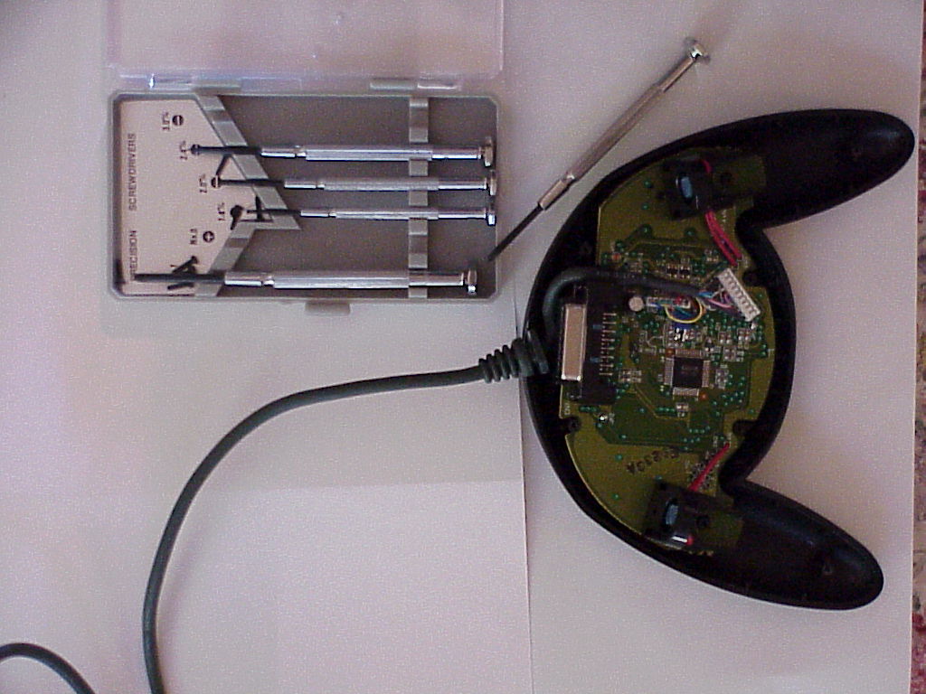

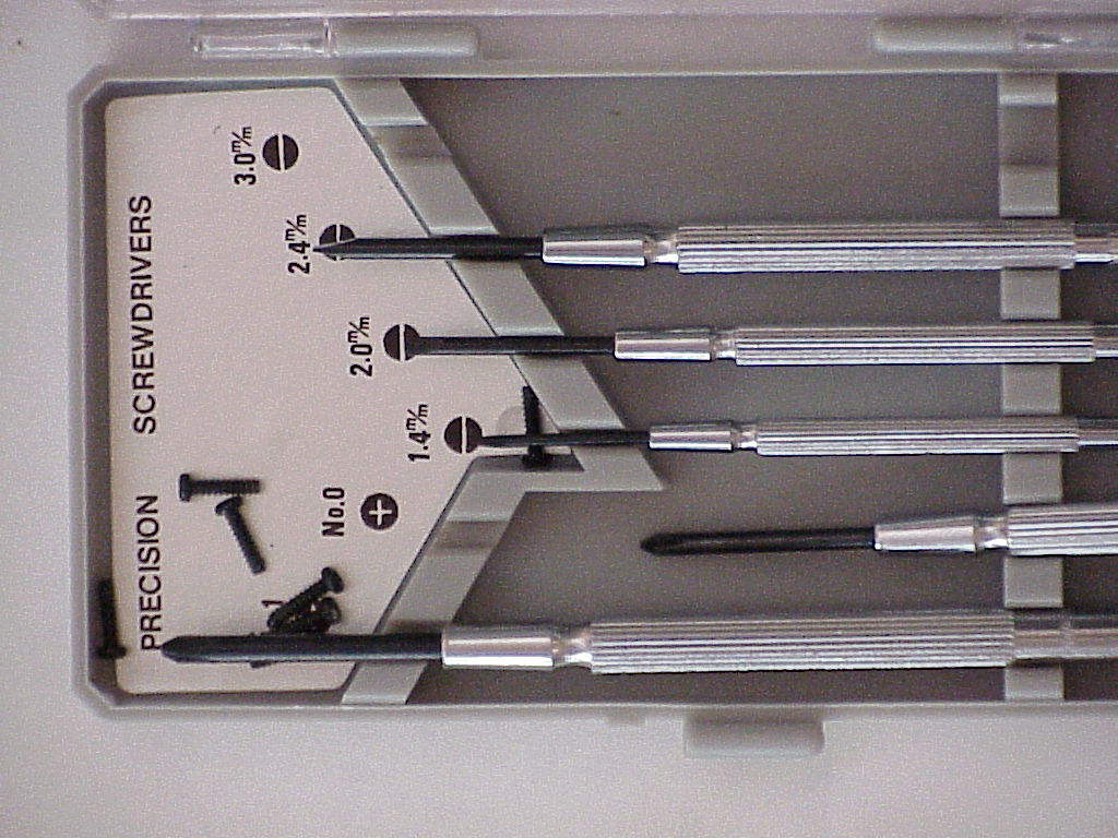

Step 1 - Open the Case

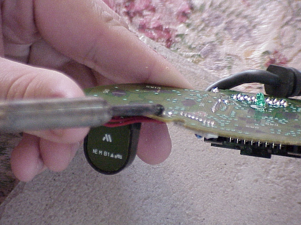

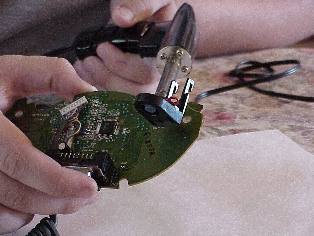

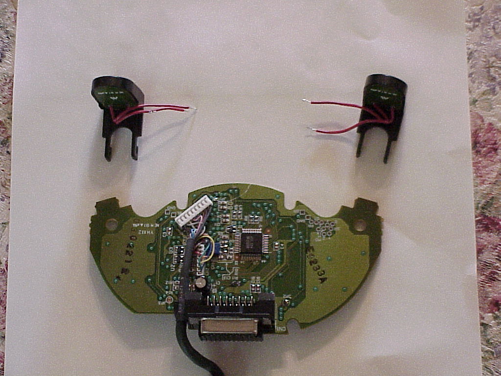

Step 2 - Clearing Out The Trigger Buttons
|   (Click for a larger view - warning, large picture) | Slide the trigger mechanism off the circuit board as shown. |

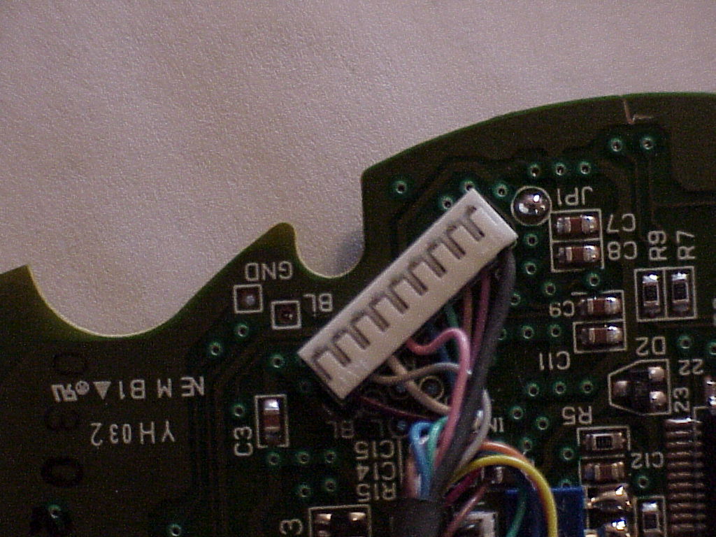

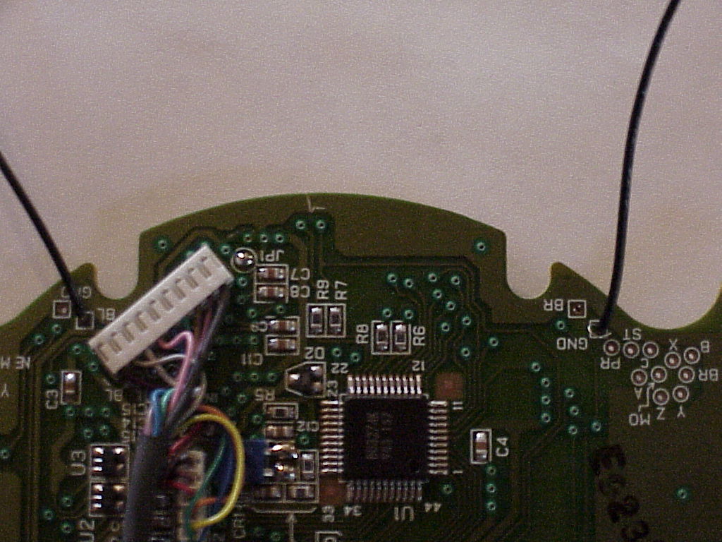

Step 3 - Two Inputs
Out of the Way
| The other trigger removed had two solder points, one labeled GND and the other BL, like that which is shown here. |   (Click for a larger view - warning, large picture) |
|   (Click for a larger view - warning, large picture) | You will only solder to the point labled BL,
using the same technique as used above. Your board should now look like
this. |

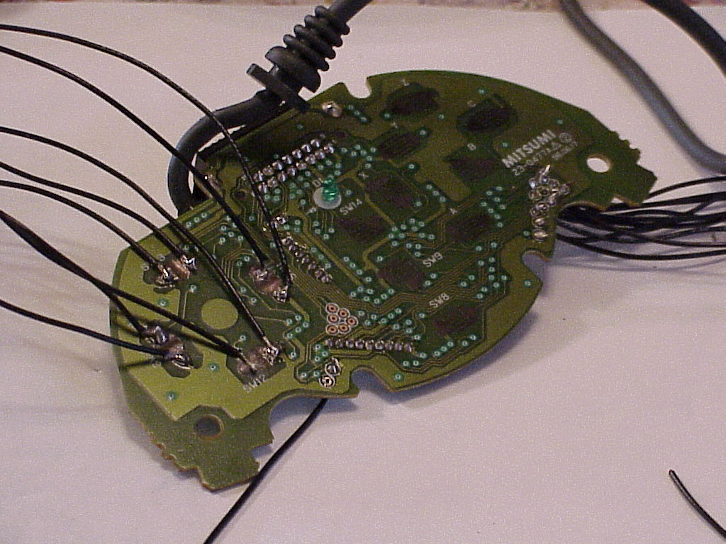

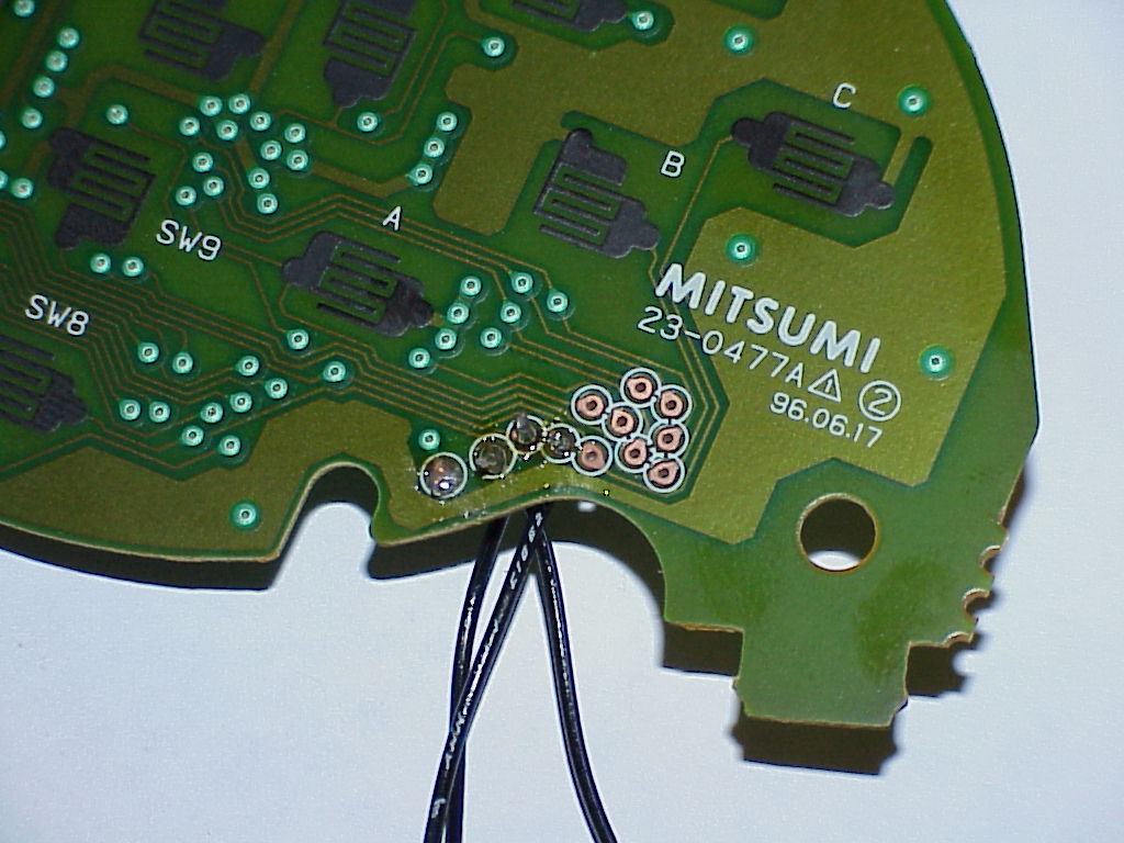

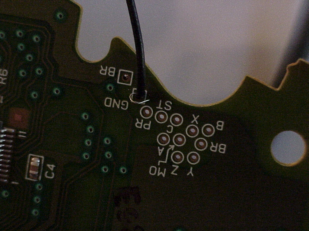

Step 4 - Soldering the Big Bunch of Inputs
There is one large big bunch of inputs which
you should solder too,  pictured at left.  Solder to every point,
except the BR closest to the ground point. Be careful and use a small amount
of solder. Go in a pattern and be careful not to leave middle solder points
for last. See picture at right for an example.
|   (Click for a larger view - warning, large picture) |   (Click for a larger view - warning, large picture) |

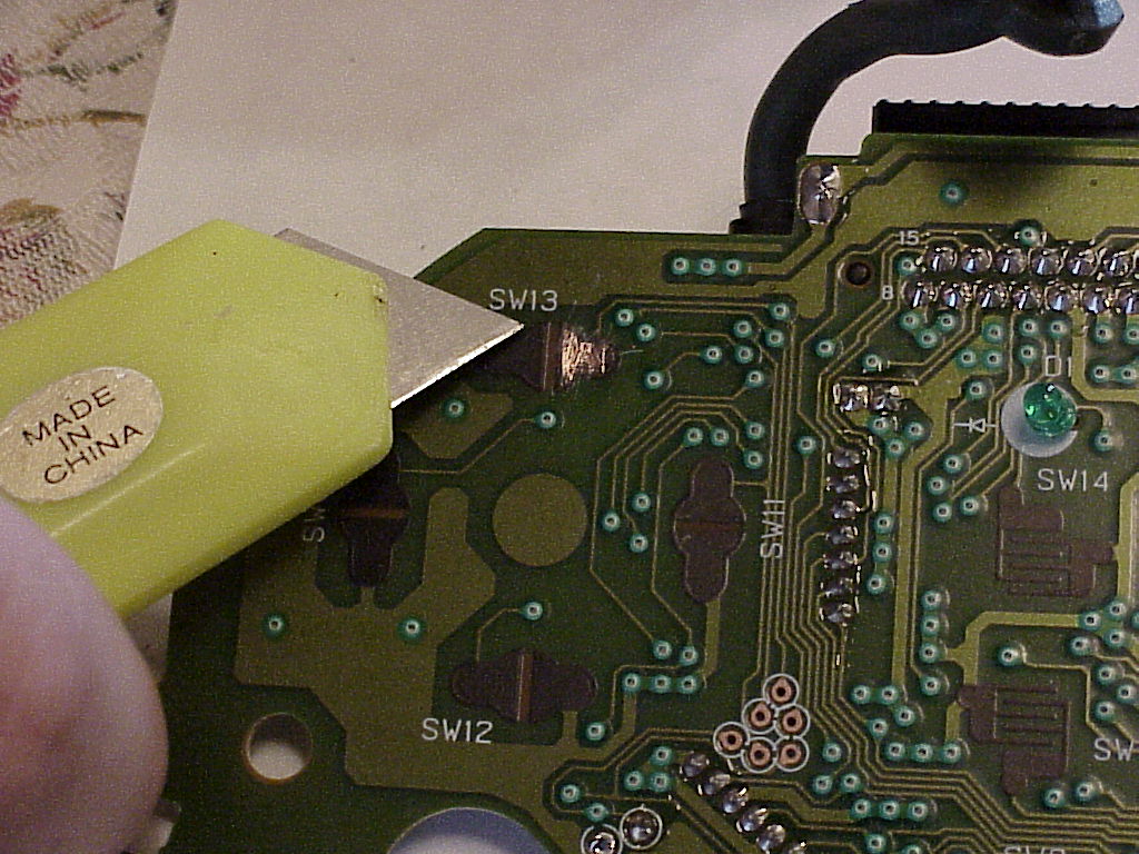

Step 5 - Directional Pad
Use a razor or box cutter as shown below to
scrape away as much plastic stuff as you can from each one of the black
contacts. Then go over the contact with the soldering iron. If you do not,
the covering melts when you attempt to solder for real. Now scratch again
to get the last of the gunk off and make sure to leave deep scratches to
help the solder adhear to the pad. The figure on the left is the contact
before being reheated, and on the right is the contact afterwords.
To solder, I found the best method was to drop a small bead of solder directly
onto the contact, and to later apply a wire and press on the wire with
the soldering iron.

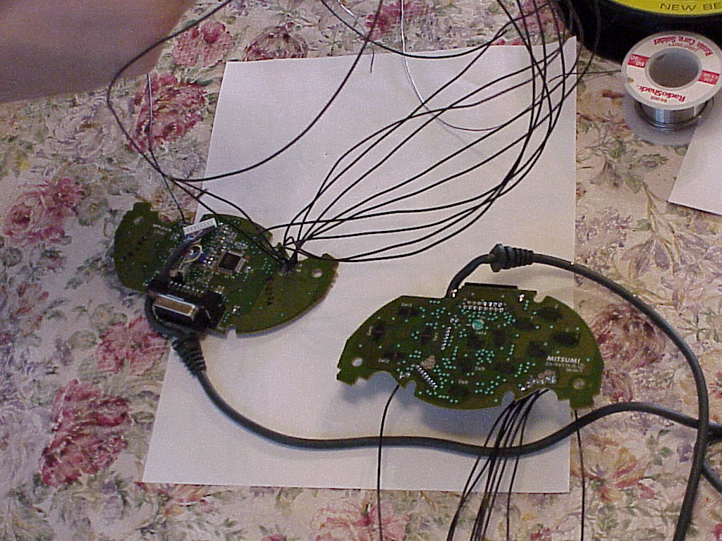

Step 6 - Barrier
Strips and Beyond
Your board should now resemble the two pictures above (where multiple joysticks at different levels of completion are shown). Bolt the whole assembly to wood and connect all the wires to screw down barrier strips. You will need about 24 sections per joystick. Connect your pad(s) to the computer and run the sidewinder test utility from control panel. Take the ground wire that used to be connected to a trigger & touch it to other wires. If the ground wire touches another ground wire nothing happens. If a ground wire touches a non-ground wire it signals a button press. Use what you know to map out which wires are which & record this information! Label each end of each barrier strip. Beware, the mode button only flashes on the controller when pressed, and not in the diagnostic utilities. The barrier strip lets you use the 5 ground inputs you have for each Sidewinder to branch out to each of your many controls. It also takes stress off your soldering. If a quick connect fails you can unscrew it and rescrew it in a second or two, and not have to worry about heating up the iron. BTW, Barrier Strips & Quick Connects cost about $12 total for each Sidewinder if you buy from Radio Shack. Make sure to order ahead as they dont carry many female quick connects in the small sizes or that many barrier strips all of the same kind.
