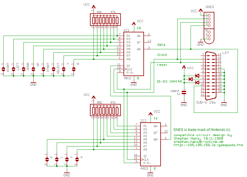

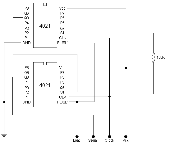

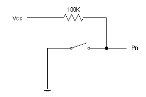

One shows how the chips are connected, the other shows how each button (or joystick) input is connected to one of the "P" pins on the chips. The inputs are read from P8 to P1 on the first chip (the one on the bottom) and then from P8 to P1 on the second. It should be easy to see how to expand the circuit if more than 16 inputs are desired. I would recommend constructing each seperate joystick with it's own copy of the circuit instead of just chaining several together.
The i/o lines in the diagram are to be connected to the parallel port pins according to the following table (see circuits.ini for more info and to change this [included in sneskey - saint]).
Line | Pin
clock | 2
reset | 3
data | 10
power | 7, 8,
and/or 9
Only the Windows version of SNESKey currently supports the arcade controller. Look in the main SNESKey.ski file to see where to name each of the inputs (ie. Up, Down, A, B, etc.).
After you have named the inputs, just construct an SKI file in the normal manner (see the example SKI files [in the sneskey download - saint]).

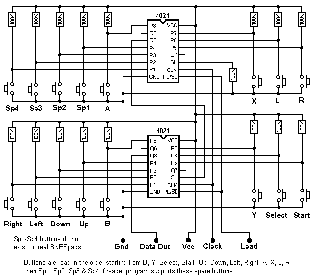

Louie's writeup
[The circuit] is basically an SNES pad type circuit made from two 4021 CMOS I.Cs that connects directly to an LPT port, and joystick and buttons connect directly to the 4021 chips.
This is the circuit I use in my arcade emulation cabinet, and it works flawlessly for me. It obviously requires some electronic experience though. It also works directly with all EMU's (that i've tried) that support SNESpads :) It is basically a SNESpad type circuit with support for extra buttons in SNESkey, however these extra buttons are not supported by any other programs.

[Config]PS: Don't forget to tell them that Stephan Hans has the circuit on his Gamepads page (SNES equivalent circuit) [or view it right here courtesy of Stephan -- saint :)]
