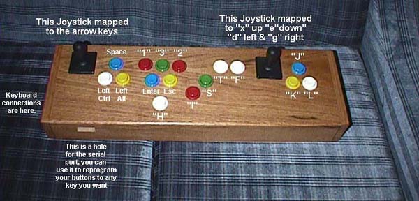

Rodney emailed me with his joystick project, and it's very well done. He's given me his blessing to share it with everyone, so here tis . . . Thanks Rodney!

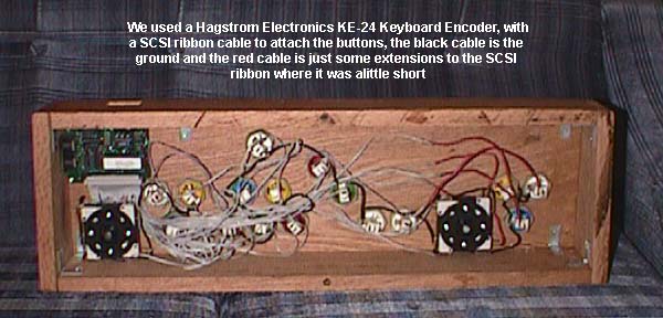

Rodney's Original Project Using the info from your pages and links I have built a Arcade Control Panel. The Control Panel used the KE-24 from Hagstrom, with the buttons and joysticks coming from Happ Controls. It is basically a Stargate Control Panel with a second Joystick for playing Robotron, additional buttons are for 1 & 2 Player Games, plus Insert Coin, esc, enter and additional mapped keys until I used up all 24 buttons! I am able to use ONLY the control panel from Windows 98 to launch Mame/w and navigate through the games, this is important because the next move is to mount it in a Arcade Cabinet for a great stand up Mame Machine.

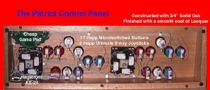

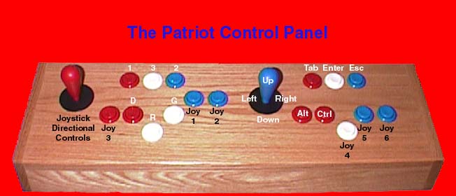

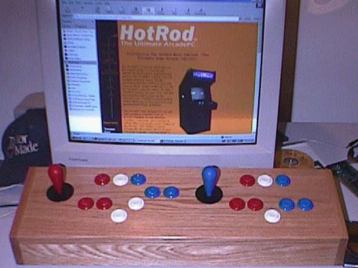

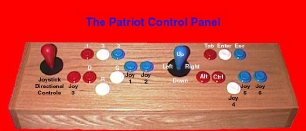

The Patriot! After his very nice original joystick control panel, most folks might have spent their time playing with the darn thing. Not Rodney! Drafting a buddy into his web of wires and buttons, Rodney and company came up with "the best keyboard layout of any stand alone project (he) has seen." :) Rodney admits to being biased, but when you look at the pictures I don't think you'll argue too much.

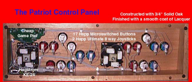

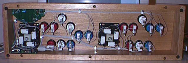

On this project, all the arcade parts are from Happ Controls. They gutted a cheap game pad for control of 6 buttons and one joystick, and used the KE-24 keyboard encoder for the rest. With this configuration, Rodney's ready to use MAME and any front end, without ever touching a keyboard or mouse!
Rodney did the design for the control panel, but his friend Mark did most of the wiring and "stuff" -- so a special shout out and thanks goes to Mark! :)
The Patriot in action! The Patriot with labels.
Inside the Patriot. Inside with labels.
