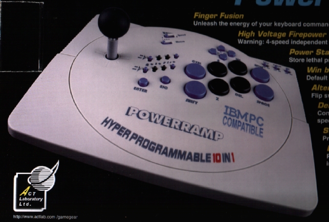

There's been a lot of excitement about using the PowerRamp from ActLabs as the brains of an arcade control project.  I know of at least one incredible cabinet that has done just that, Roswell 88201.  After they dropped to $20(!) I purchased one myself to see what it was all about.  Unfortunately, they are no longer being sold.  However, in the event you find one, perhaps this will be usefulThey appear to be available again!  They're not available again, and this time it looks permanent :(  On this page you'll find pictures I've taken, message threads about the PowerRamp, and any other info I can gather.
The Specifications

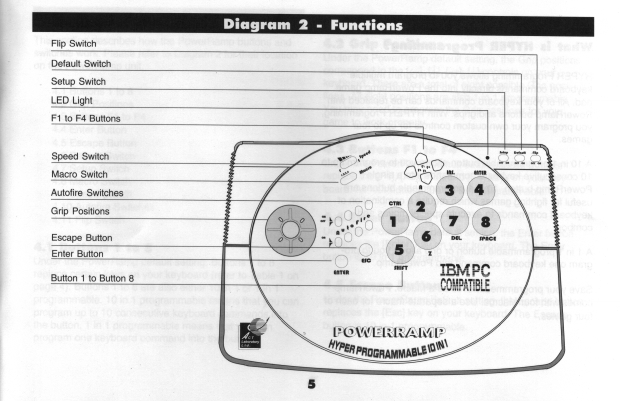

Adding up the above, you can see the PowerRamp has 22 programmable inputs you can use, along with a variety of optional toggle switches to modify their behaviors.  14 of the inputs are straightforward "connect-wire1-to-wire2" types.  The joystick is programmable along all 8 directions, but only has 4 micro-switches under it.  Up/Down/Left/Right will be straightforward, but to use a button for the diagonal, I expect you'll have to rig your arcade control button to activate two buttons on the PowerRamp joystick, simulating the diagonal direction.
Updated! (From a message by Tom61):  A note about the autofire switches - they don't appear to register to most classic MAME games.  I've wanted to use autofire in Vanguard, but it only registers the first press.  I think that the repeat rate is too fast (even in PowerRamp's "slow" setting) and registers as a held down button.  (Thanks Tom! -- saint)
(From a message by Spazzman): Via two of toggle switches, you can choose up to five different pre-programmed settings.  I.E. you can program a layout for MAME, then switch to layer 2 and program a layout for Callus, then layer 3, and layer 4.  Of course, doing it this way means you'll need to mount the toggle switch somewhere accessible.
Daisychaining:  The PowerRamps can be daisychained allowing theoretically double the number of controls.  However - there have been reports of problems with stuck keystrokes in daisychained situations.  See the message captures for more information below.
Programming:  Programming the PowerRamp can all be done via the joystick itself - no software required.  This makes it an ideal interface for people running non-MS operating systems.

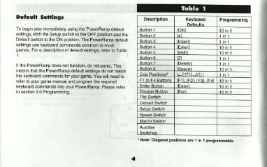

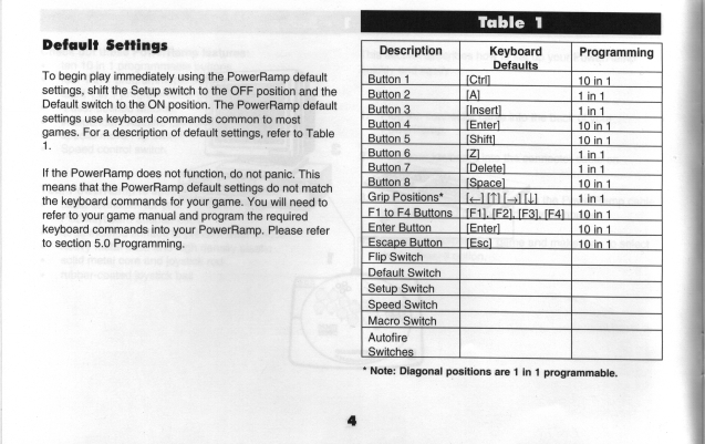

Click for a larger view! Figure 1 - table of the default programmed settings of the PowerRamp.

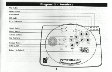

Figure 2 - Diagram of the various controls of the PowerRamp. Click for a larger view!

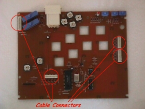

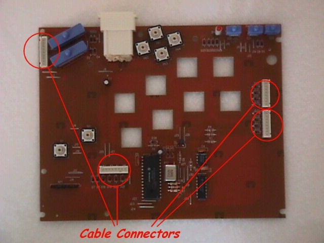

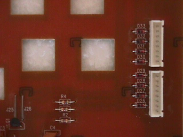

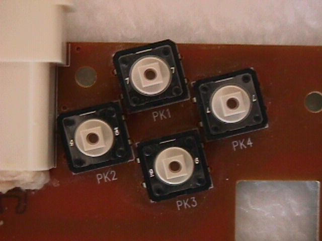

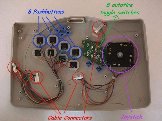

The PowerRamp's circuit board.  Notice the circled cable connectors.  These are your easiest connection points.  The other buttons and switches will require soldering to the pcb most likely.

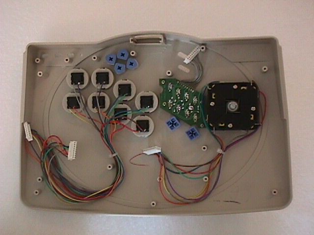

Under the case of the PowerRamp.  Notice the corresponding cable connectors for the PCB.  The 8 pushbuttons are easy hacks.  The 8 autofire toggle switches not as easy.  The joystick should also be an easy hack.

An uncluttered view under the case of the PowerRamp (same as above minus the captions).

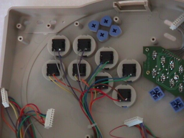

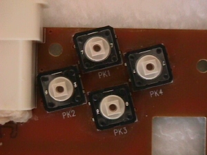

Close up view of the buttons underneath the case.  Click for a larger view!

The other buttons are actual pushbuttons soldered onto the PCB and will require more effort to hack.  Buttons originally configured to these controls are F1,F2,F3,F4,Enter, and ESC.  Of course, any of the buttons can be reprogrammed.  The only other controls not accounted for are 13 toggle switches - the 8 autofire switches, and 5 configuration switches.

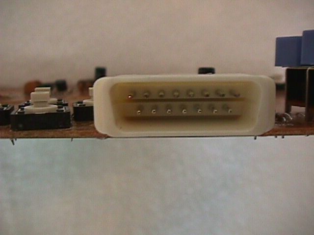

Close up of the cable connectors on the PCB.  Just to add fuel to the diode debate, notice that every input on the PowerRamp is run through a diode. Click for a larger view!

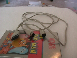

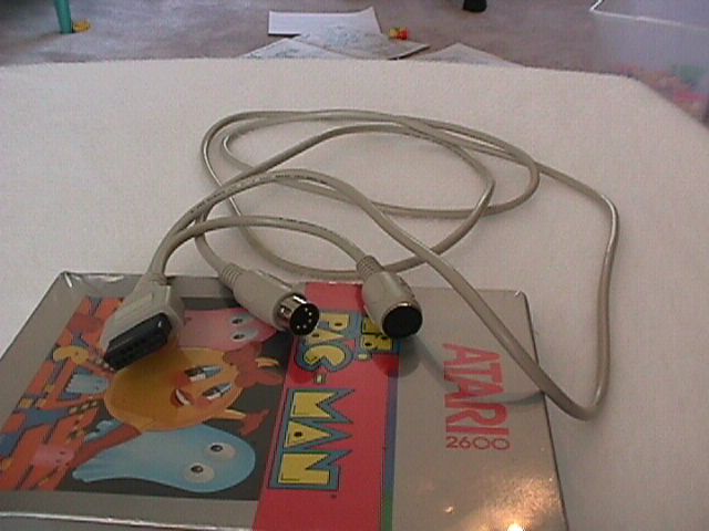

The keyboard connector.
The keyboard cable - nice the passthru for your keyboard.  AT style keyboard cable shown here, PS/2 cable also included with PowerRamp. Click for a larger view!
(Click for a larger view)
