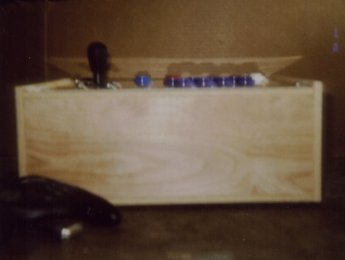

Polaroid's are amazing in the sun
I made the unit with the following parts:
  • A 4-way / 8-way "Super" Joystick from Happ Controls
  • 11 "Ultimate" Pushbuttons from Happ Controls
  • 30 female solder less connectors from Radio Shack
  • A few feet of standard speaker wire from Radio Shack
  • Some pieces of tape for wire harnesses and labels
  • 1 Microsoft "Sidewinder Game Pad" from Wall Mart
  • A 2 x 4 of Birch purchased from Home Depot, cut to 17 X 14 X 6 3/4 (7 on the sides)
  • A thin layer of Plexiglas for the cover cut to 16 x 14
  • Some wood glue
  • Standard woodworking tools (borrowed them all)
  • 7 2 x 1/4 inch cover bolts (forget what they're called) for the joystick and plexiglas in 3 corners
  • 7 1/4 inch nuts
  • Some rosin core solder from Radio Shack
  • A 15 watt soldering iron from Radio Shack
