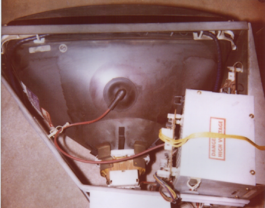

    A picture's worth a thousand words
    (or volts)
    Here you see a monitor without a case around it.  On the monitor you'll see a little suction cup (anode) about 1 or 2 inches across. Probably dirty filthy black. Sometimes on  top of tube, sometimes bottom, sometimes side - it depends on the monitor's orientation :)  There will be a big wire coming out of it going into the electronics of monitor.
    Click me for a full sized picture!
    (Click for larger view)
    The monitor's anode, looking
    down on monitor from above.
    Notice the "Danger, high voltage"
    label in the larger view.
    The anode is one end of the "capacitor" - anything metal including the framework is the other end.  You want to be careful touching any part of the electronics while you hold metal framework in case of a short circuit somewhere, but you particularly don't want to ever touch the anode or red cable coming out of it until it's been safely discharged.

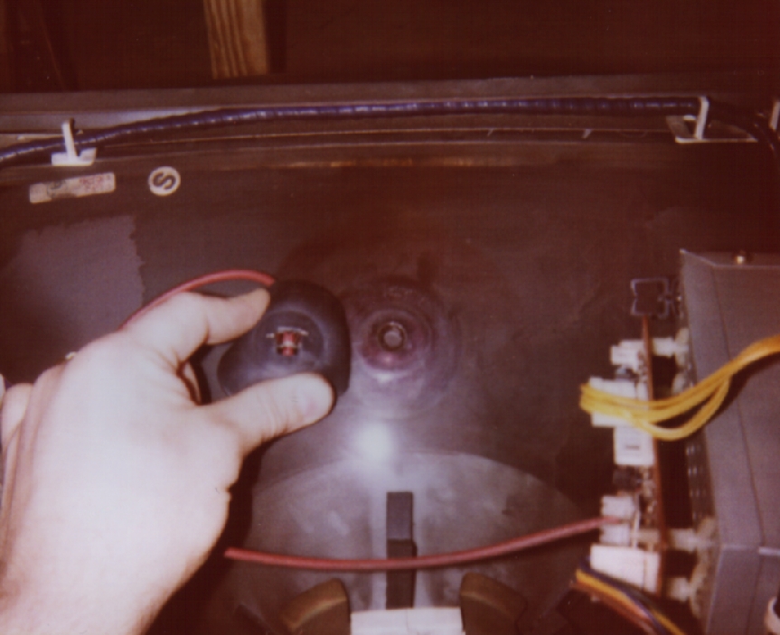

    The beast defanged
    The suction cup removed.  You can't
    see it well, but there are two metal posts
    that come out of the wire that insert
    into the opening in the tube.
    One word to the wise - if you have a monitor you haven't worked on in a while, discharge it before working on it even if you know that it was discharged - better safe than sorry.  At least one person passed on the story of a friend who had seen a monitor on a table, plugged it in out of curiousity, then unplugged it when nothing happened.  The friend failed to inform the person he had done so, and the person found out the hard way when we went to work on it - ZZzzapp!!  Presumably they had a discussion on it later . . .
