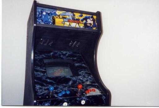

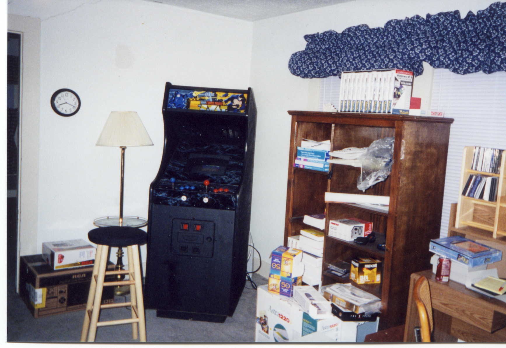

The cabinet is an Eswat machine originally purchased at an auction for $75. I gutted everything, replaced the monitor with a 15 inch CompUsa monitor, and mounted it with self brackets bolted into the monitor case (had the take the monitor apart of course to find a safe place to mount the bolts). |
The control panel was originally an ugly red/black nasty looking overlay. Removed that and replaced it with the almighty marble contact paper. This was also what I chose to use as the monitor bezel. For that I used a piece of posterboard, cut a hole in the middle to match the monitor's size/placement and covered the posterboard with the marble contact paper. |

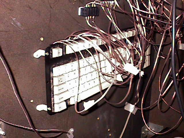

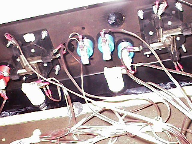

As for the actual controls, the only thing I did was to replace the buttons. Everything but the joysticks are new. The joysticks are the leaf style which work really well for all types of games. The buttons were purchased from Happ Controls - an excellent source. |

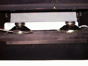

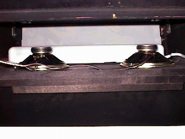

The marquee stayed the same. The only thing added was a $15 under-the-counter fluorescent light behind (the lights that came with it barely did anything). |
I put microswitches behind the coin return slots, so when the left coin return slot is pressed it signals an insert coin. The other coin slot serves as the ESC key. Also, these slots are now lit. They didn't come this way - I bought lights that fit almost perfectly in the slot and they are being run by a universal switchable power supply (the ones that have a gazillion connections of the end the wire that you buy at Wal-mart for $10). |

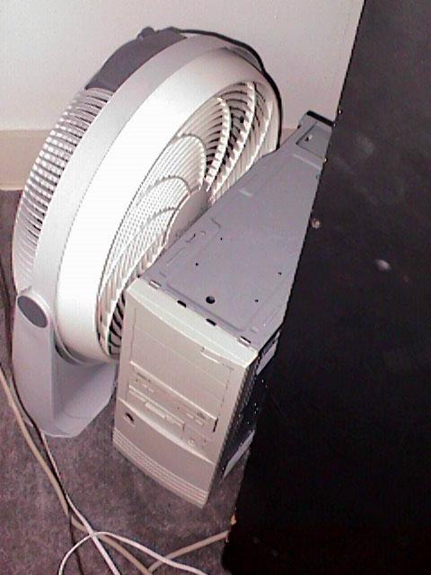

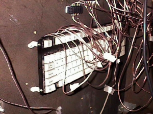

The cpu is a pII 350 with 32 megs of ram running Arcade@Home. As you can see from the picture, the computer has a small heat problem so I have a floor fan keeping it cool (Hey, whatever works, huh?) |
As for the cabinet itself, not a ton of work was required. When I got it some of the black was scratched off, especially on the sides, so I painted the entire cabinet. One major thing was ... I HAD TO CLEAN EVERYTHING(!) from the coin slots to the inside bottom of the cabinet. This was the part I hated most about this project, but I guess it's a required step. |
