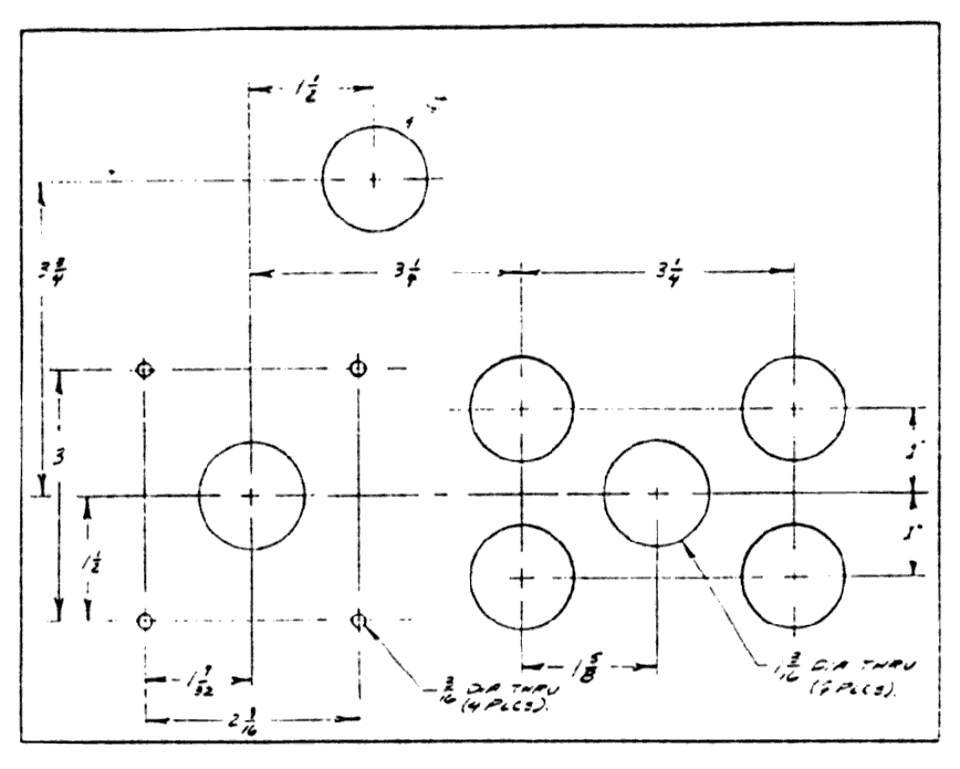

I started the project by first buying a Mortal Kombat I manual off of eBay. (Side note: if you're into arcade machines, check out eBay's Coin - Operated Listings. Even if you don't have the money to buy anything, it's still fun to see what's out there.) I bought the manual for around $5. Inside the manual there was a layout for all of the buttons and the joystick. I scanned the diagram and have it here:
Low Res
High Res

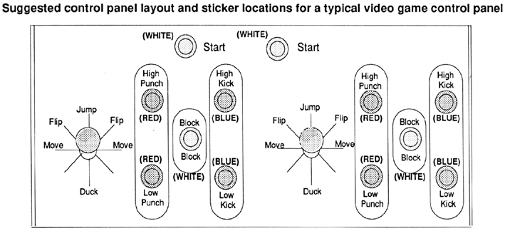

I also was unsure about which color buttons I wanted to get. Being that Happ offers a wide variety of colors, I thought I would see what was used with the Mortal Kombat cabinets. On the same page as the hole layouts, there is a suggested sticker layout diagram. The diagram also states which buttons are what color. I have also scanned that diagram and have it here: Suggested Layout.
As much as I like Mortal Kombat, I've always wished Midway would have used the Street Fighter II style layout. The 2 rows of 3 buttons is, IMHO, the best layout for most games. So I modified the MK layout by moving the middle button up to be in line with the other two side ones and then just added another button to the bottom row.

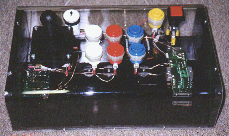

Originaly I had planned on using just plain press wood for the housing. But after talking to a guy I know, he said he could get me some 'scrap' 3/8"plexi glass. The plexi glass he got me wasn't just the ordinary stuff either. He got me the stuff that could be heated and bent without it turning milky white. He ended up making the housing for me too. He later told me that bending just one side of the housing took 30 minutes.

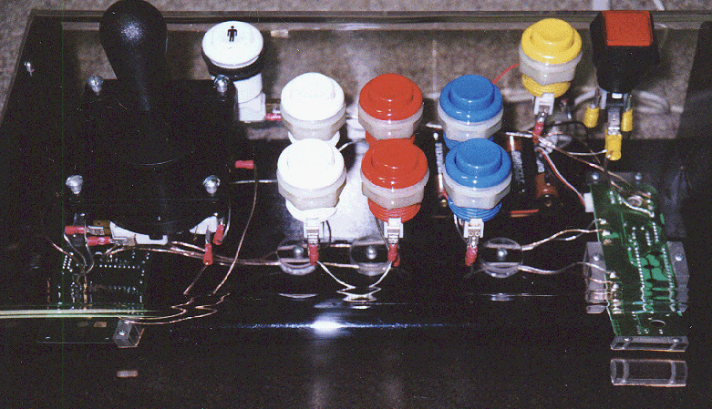

Once I had everything together and the housing was basically done, I started to drill the holes. Plexi glass is great to work with. Drilling through it is like cutting butter! For the buttons I used a 1 1/8" hole saw and for the joystick I used a 15/16" hole saw. Since this was my first project, I was making things up as I went. After I started, I decided to make the mounts for the GamePad and MouseStick II PCB's out of plexi glass as well since I had a peice of scrap. I also used the cut outs from the buttons as a kind of wire tie down.

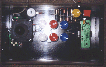

The one fairly unique thing about this joystick is the red, square button in the upper right corner. One the back of the joystick there is a small red toggle switch. Pressing the switch turns on the light in the square button. The reason I did this was do try and get more of an arcade feel. Since the insert coin button on an arcade machine glows and I needed an insert coin button on the joystick, I thought this would be cool. Had I known how much of a pain it was going to be to add this to the joystick, however, I would have skipped it.
In order to get the light to glow it needs power (duh). Put once I took apart the two controllers I realized there isn't enough power going to either one of them to light up the bulb. So I had to rely on batteries to get the juice I needed. One of the first things people say about the joystick is why do I need 6 AA batteries to power such a small bulb. How should I know, I just know that's what it takes :P

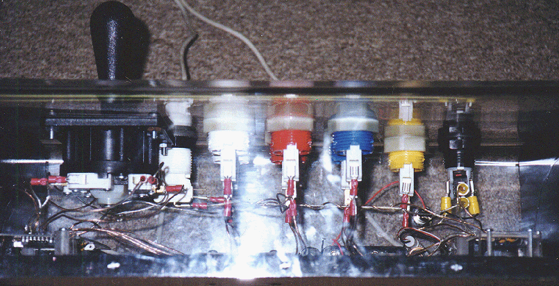

The next problem was making the button activate the micro switch when it was pressed. There are basically two main parts to the button. There first part is the outer housing and the button. The second holds the micro switch and bulb. When I first got the button, if I pressed it, this would cause the micro switch to move out of the housing and not activate. So to keep it from doing this I had to rig a spring to the micro switch and to the houseing to keep them together. This was a lot easier said than done. Hopefully I'll get a picture taken of this some time.
The rest went pretty good. Wiring and soldering was a lot easier then I expected. If you look at the PCB's you'll see there are two circuits going to each button. One is specific to that button. The other is the common/ground and also goes to all of the buttons. Then all you need to do is solder the appropriate wire to the correct solder point an the board and you're ready to go.
Now that it's done and over with, there are some things I would change. As mentioned earlier, the button with the light would go. It's a cool addition, but the added cost and frustration weren't worth it. Next, as cool as plexi glass is, I have no plans on making another joystick with it. Becuase I used plexi glass, I wanted all of the wires to look good inside. Again, this added a lot of frustration. Also, I can't take the cover off easily becuase the wires are connected to the buttons and then are held down to the base, basically holding the top and bottom together.
Another small detail thing that you might notice is the buttons aren't in the right order color wise. I wasn't paying attention when I put then in last time and they aren't in order. They should be red, white, blue. And because it's such a pain to get inside the housing, it will probably be a while before I change this.
In the end the joystick turned out ok. I learned a lot of interesting stuff and know what NOT to do next time I build a joystick. The total cost for the project was about $100. But a lot of the supplies (wire, solder, etc.) I bought can be used for my next project. Right now I'm thinking about building either a NeoGeo joystick, a 2 button joystick for older games, or some sort of joystick for use with Ikari III (this requires a dial-joystick combo).
