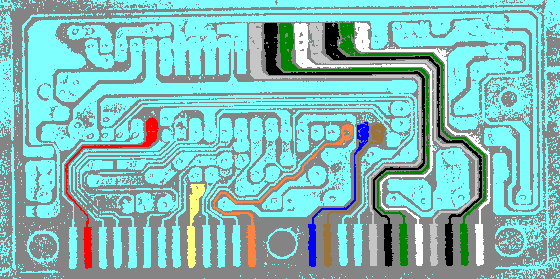

5. Looking at the circuit board, you should now see 25 contacts running along the bottom: a grouping of 13 followed by a grouping of 12. These are the contacts between the PC board and the membranes; the first 15 contacts mate with the vertical planes while the last 10 mate with the horizontal planes. Imagine that the contacts are numbered 1-25 from left to right. The contacts that we will concern ourselves with are 2, 9, 13, 14, 15 (vertical) and 18-25 (horizontal). The applicable contact tracings are color-coded in the image above. (IMPORTANT NOTE for M.A.M.E. Users: If you're going to be using your controller primarily with M.A.M.E. and plan on installing the computer into an arcade cabinet, you may want to tap into contact 1 instead of contact 9; contact 1 will give you controller access to the "1" ("One Player Start") key without having to access the keyboard!) (Contact 1 also grants access to the "Tab" key for the M.A.M.E. menus.)
6. Next you will need two DSUB-9 male connectors, either chassis-mount or as a cable-end connector. Chassis-mount connectors make for a more professional finished product, but its far more convenient to use the other end of the Sega extension cord that we'll be cutting to make our controller cables.
b. If you decide to go with cable-end connectors, cut your Sega extension cables so that two-thirds to three-quarters of the cable is attached to the PLUG END (female end) connectors. Strip and tin VERY SHORT LEADS from each of the 9 wires on both ends of both connectors. (NOTE: the conductors in the Sega wires are made to withstand snapping, and so are a thin copper coil encircling a filament rather than a standard stranded wire; due to the delicacy of these conductors, use the appropriate caution when tinning and soldering these wires.) Set aside the PLUG END portions of the cables for now, and solder the PORT END cables to the circuit board, observing the color-coding on the circuit board diagram above.

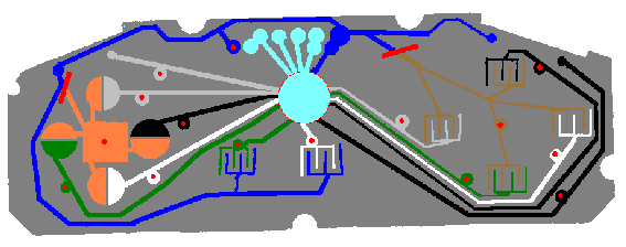

2. There are TWO different possible internal circuits for this controller: the surface-mount version and the conventional version. Of course, the surface-mount (SMT) version is more recent, and will PROBABLY be the type you will wind up with. Either is okay, though the conventional version may be a LITTLE bit more tricky to wire up. What is MOST important is that both controllers are of the SAME TYPE of circuit! (If you wind up with two mismatched controllers, buy a third, then return the one that doesn't match. Both controllers need to be wired identically so you needn't keep track of which is which when you plug them in.) I have only diagrammed the SMT version here, but the other is very similar.
3. Cut the tracings as indicated by the heavy red lines on the diagram to isolate the direction pad, the A-B-X-Y buttons, and the L-R-Select-Start buttons.
4. Cut around the perimeter of the SMT chip (the black enamel blob in the center of the board), making sure that ALL tracings are fully broken.
5. Using a hobbyist's drill, drill holes as indicated by the red dots on the diagram.
6. The white, black, gray and green planes (3 of each color) must be wired to the others of like color. To do this, you can either sand the tracings clean around the SMT chip and solder jumpers to the tracings, or solder jumpers to the holes you've just tapped into the board. (Jumping across near the chip is preferable, as wires inside the controller casing should be kept to a minimum.)
7. Using the PLUG END cables that we set aside earlier, solder the tinned leads to the SNES circuit board, matching the wire color to the diagram above.
8. Tie a strain-relief knot in the cables and reassemble the controllers, taking care to keep the wires from being pinched, or interfering with the buttons.
