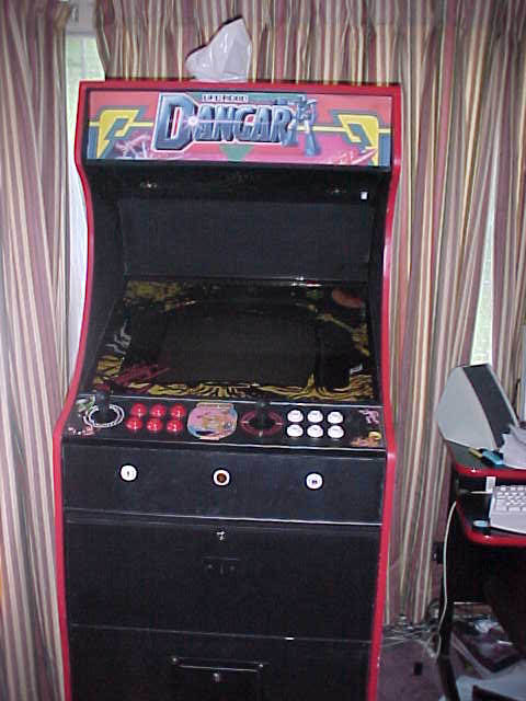

Gerald's quest for a cabinet
started from the moment he first laid eyes on MAME. A day after graduating,
he tracked down an old Tetris cabinet made in Chile. He explained
his project to the guy he bought it from, who didn't believe him... Sound
familiar? The results are slick ... :)

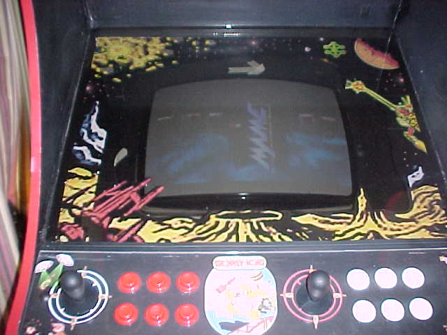

The monitor bezel
artwork was made by Gerald,
with the graphics
coming from a very blurry
and small image of
Space Invaders, and a few good
quality flyers for
some old games. It's a bit hard to
see, but that's the
"MAME Video" running on the monitor :) |

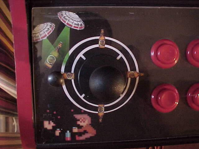

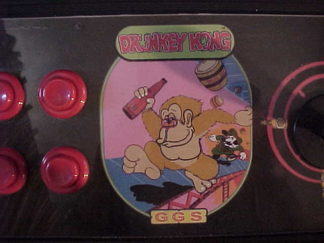

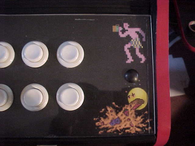

The control panel
artwork done by Gerald's friend. Take a careful look ... Think his
friend has any particular interests? :)
(Click for a larger view) |

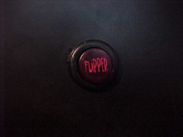

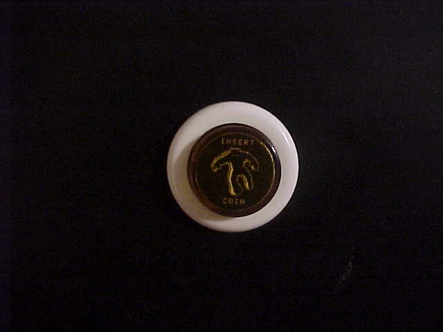

I also like the
artwork on the buttons. Once more, I find something that I want on my cabinet

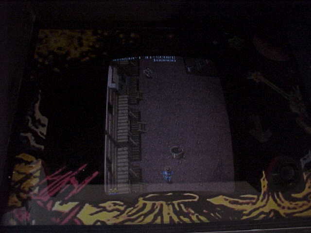

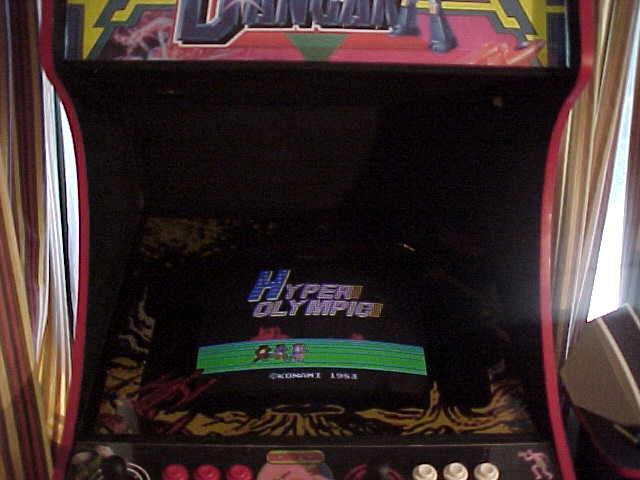

On the left, you
see Hyper Olympic, a horizontal game playing on the 20" monitor.
On the right is Gunsmoke, played vertically... It took Gerald about 15
seconds to rotate the monitor!

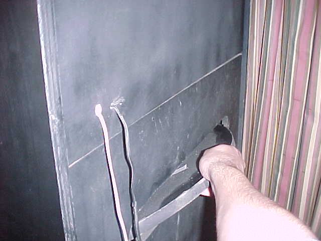

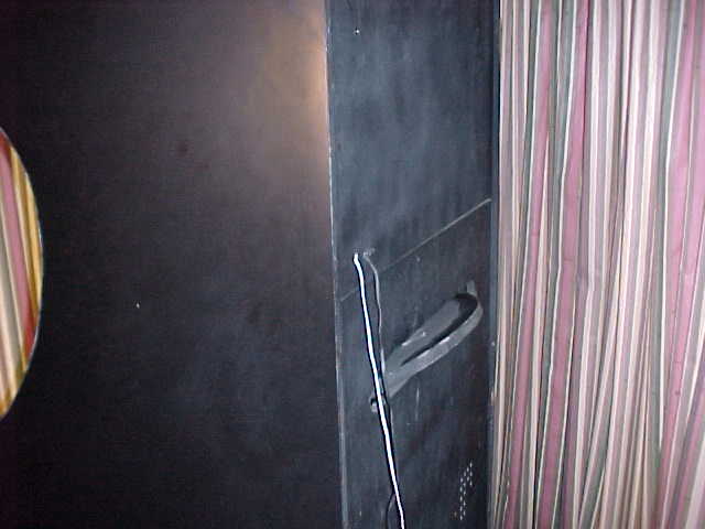

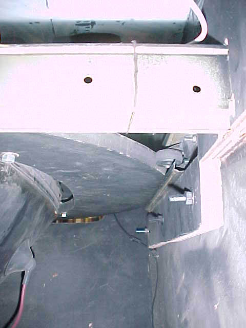

Here's the back
of the cabinet. You can see a round disc coming out of it -- this is what
the monitor rests on. You just put your hand in the back of the cabinet
and rotate it "like a tuning knob of a very big radio." The picture
on the right is below the monitor, from the front of the opened door for
maintenance. You can see wheels that help the rotation to be smoother.

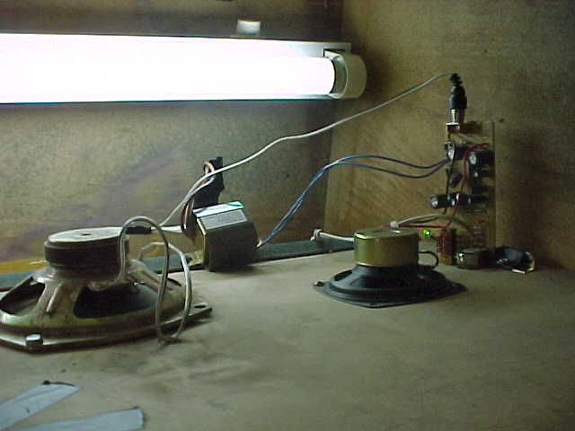

Here's the audio setup,
behind the top marquee.
The speakers were
cheap computer speakers, completely disassembled. Notice that the
PCB of the amplifier is stuck on the wood, and the audio controls can be
used from the other side. Also, Gerald used a fluorescent lamp to
illuminate the top marquee. |

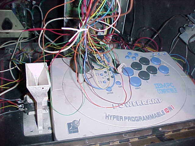

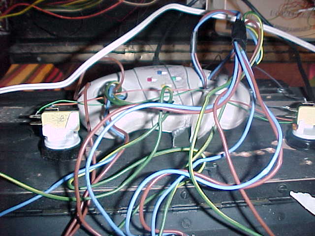

For the maintenance
buttons and the second player controls, Gerald used a hacked PowerRamp.
One nice touch is that the coin slot is fully functional via the PowerRamp
as well. |

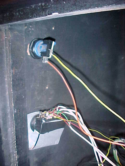

A problem Gerald had
with his system was a bit of flakiness with the monitor. Whenever
the resolution changed, the picture went out of sync, with lots of diagonal
lines. (The monitor was a 15 year old monitor).
The workaround was
to unplug/replug the VGA cable from the PC - not terribly elegant.
Instead, Gerald made a "reset" button consisting of 5 microswitches connecting
the input wires. When you press the button it disconnects the 5 wires
of the vga input and reconnects when you release the button. |

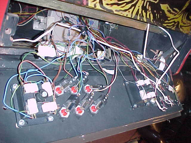

Spaghetti time.
This is a shot of the underside of the control panel. Notice leaf
based pushbuttons, which Gerald prefers over microswitch. |
For the player one
controls, a simple $6 gamepad was hacked. |
