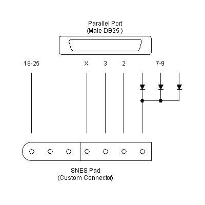

Connecting SNES Pads
[Schematic of SNES Adapter Circuit]
The "X" above should be replaced with a 10, 12, 13, 15, or 11 for the first, second, third, fourth and fifth SNES pads, respectively. Connect all the other pins exactly like the first pad, then connect the data line of the first, second, third, fourth and fifth SNES pads to the appropriate pins on the DB25. Configuring these controllers is discussed in the section about the ini files.
You can also "mix and match" NES and SNES control pads by connecting the data lines to whichever pad you wish (for example connect the first and second data lines to SNES pads, and connect the third and fourth to NES pads. You would then refer to the SNES pads in the ini file as [SNES 1] and [SNES 2] and the NES pads as [NES 3] and [NES 4].

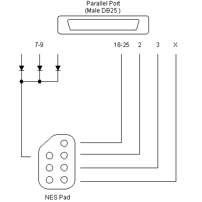

Connecting NES Pads
[Schematic of NES Adapter Circuit]
The "X" above should be replaced with a 10, 12, 13, 15, or 11 for the first, second, third, fourth and fifth NES pads, respectively. Connect all the other pins exactly like the first pad, then connect the data line of the first, second, third, fourth and fifth NES pads to the appropriate pins on the DB25. Configuring these controllers is discussed in the section about the ini files.
See notes on SNES pads for information about mixing NES and SNES pads.

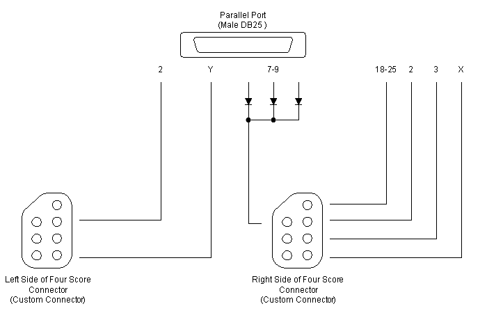

Connecting NES Four Score Adapters
[Schematic of NES Four Score Adapter Circuit]
The left/right side of the plug is determined by looking directly at the side of the connector that plugs into the NES console.
The "X" above should be replaced with a 10 for the first Four Score and 13 for the second. The "Y" above should be replaced with 12 for the first Four Score and 15 for the second Four Score. Configuring the Four Score adapters is discussed in the section about the ini files.
For some reason, on my machine the turbo mode (auto fire) on the Four Score doesn't work. I think it is because it isn't getting enough power.
Other pads can work in parallel with one or two Four Scores. Just compare the circuits to make sure they only share power and ground.

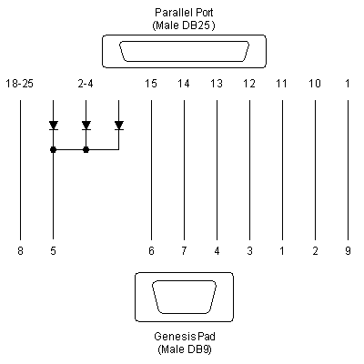

Connecting Sega Genesis Pads
[Schematic of Genesis Adapter Circuit]
This circuit works for both 6 button and 3 button Genesis pads. Use [Genesis3] as the title of the config section for a 3 button Genesis pad and use [Genesis6] as the title of the config section for a 6 button Genesis pad.

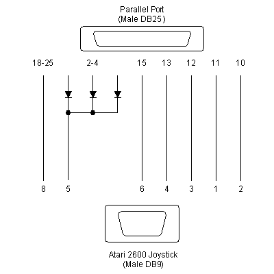

Connecting Atari 2600 Joysticks
[Schematic of 2600 Joystick Adapter Circuit]
The connection to pin 1 (power) on the controller should not be necessary for normal joysticks. Build the circuit without it first, and see if it works. Use [2600] as the title of the config section for an Atari 2600 controller.
A 2600 joystick will also work when plugged into the Genesis circuit.

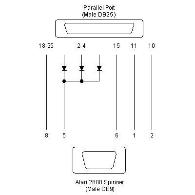

Connecting Atari 2600 Spinners (Driving Controllers)
[Schematic of 2600 Spinner Adapter Circuit]
For a single spinner, you can use the same circuit as the Atari 2600 or Genesis adapter, that way you can just swap the controllers out, depending on which you want to use. The connection to pin 1 (power) on the controller should not be necessary. Build the circuit without it first, and see if it works.
Use [2600 Spinner] as the title of the config section for an Atari 2600 spinner. Use [2600 Spinner N] where N > 1 for spinners other than the first one. You may need to increase the TickFreq setting in the spinner ini file to as high, or higher than 200 to get good results.
To simplify the diagram above, I'll just describe how to connect a second or third spinner. Pins 5, 4, and 9 for spinner two go to pins 12, 13, and 1, respectively. Pins 5, 4, and 9 for spinner three go to pins 14, 16, and 17, respectively.

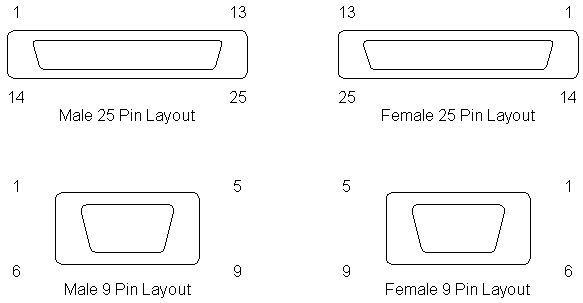

Standard Pin Numbering
The diagram below shows the way standard connectors are numbered. All the connectors are shown from the front.
