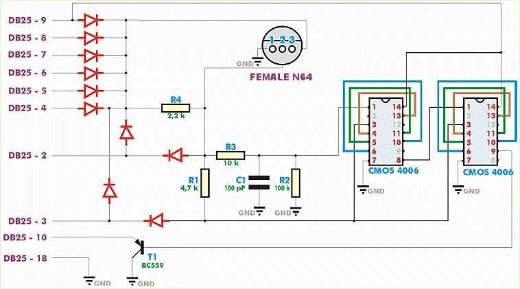

Schematic of the circuit
If you want to print a high-quality version of the schematics, get this .WMF
Circuit in
WMF format (Windows metafile)
As you can see, the circuit is a bit more complicated than the PlayStation one.
If you pay attention, the connections to the chips (4006)
leave and then return to enter the same chip. They are of different colors simply to make
it easier to see the individual lines. They do not mean anything else. Both chips
have the same configuration of connections that leave and return to enter.
Please use maximum care when putting the transistor
(T1) and the chips into circuit, since if you are
mistaken, you may fry them.

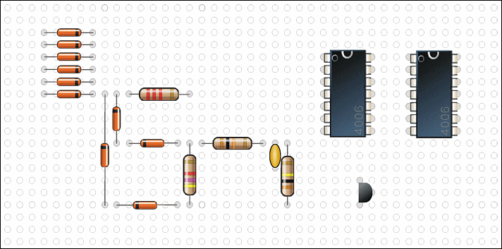

Aside from this, the greater complication of the circuit resides in being a
little patient(?) to be able to make the connections under the experimental board. And following
with my intention of making this as easy as possible, I drew out the graphical way or how I mounted
the components, in case you need the guidance:

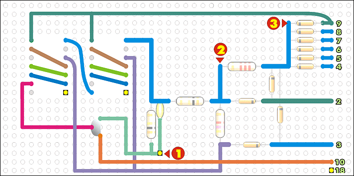

Assembly of the components on the prototype board
The connections will be made on the underside.
I recommend that you cut off a 6 inch piece of the 10 conductor cable so you will have
wire to make the connections on the underside of the board when the component leads aren't
long enough.
And now we see the connections, looking up from the under-side of the board.
Take into account
that this view is not the same one that the one of above, it is horizontal mirror supposing
that the circuit board is transparent (I know, nobody has X-ray vision to see it in reality).
View of under-side of proto-board (with top side visible for reference)
The purpose of the different colors in the drawing is, like always, to avoid confusion.
Now, I'll explain some other things to you.

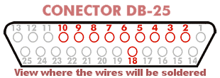

The green numbers on the right are the points where the 10 wires
will connect to the pins on the DB-25. Solder in each one of the wires to
the circuit board, then solder the other end on the male DB-25 connector
as it corresponds to the drawing (according to the green number).
This symbol,
corresponds to the ground. You should solder a wire in each one of these points and
to take them all to the point where we will solder the wire corresponding to pin 18 of the DB-25.
The yellow numbers in red circles
correspond to the female connector of the Nintendo 64 controller.
To the right is a picture of the female connector.

DB-25 Connector
We have already done the most difficult part. All that's left now is making the
connections to the DB-25 connector and to make the connections with the female
connector on the N64 controller.
To the right, we have the image of the connector with the pins that we are going to solder in red.

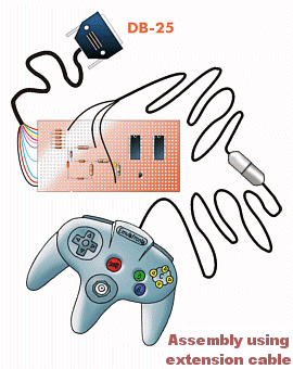

In order to connect the N64 controller to the circuit we have two options: a clean, but
expensive method, and a less clean but free method.
The cleanest method is to buy an extension cable for the N64 controller
($8 at Wal-Mart), cut the cable and wire it
directly to the points of the circuit. It is advisable, before soldering, to
verify with a meter which color wire goes to what holes of the female connector. Then solder the wires to the circuit
on the spots marked
Less clean (more dirty ;-) it is to connect three cables to the points
and to strip enough insulation from the wires and push them directly in the holes of
the female connector on the N64 controller.
While this may seem cheesy, I can assure to you that it holds well enough. He is known to
do this whenever we move controllers from the console to the PC, but if you don't want
to spend the money for the extension, this is the only option (other than hacking a connector off a controller
and hard-wiring it).

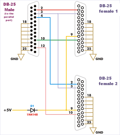

EXTRA
To connect a second pad to the same parallel port
Thanks to Stephen Hans (Father of this invention), and to Earle of DirectPad 5.0, it is now
possible to connect two N64 controllers to one parallel port. For it, you will have to make another
circuit assembly identical to the original. You will also need these additional components:
List of components to make the adapter for 2 pads:
COMPONENT 1 |
DRAWING |
| 1
diode 1N4148 D1 |
COMPONENT 2 |
DRAWING |
1
male DB-25 connector with cover |
COMPONENT 3 |
DRAWING |
2
female DB-25 connectors with covers |
COMPONENT 4 |
DRAWING |
1
meter of wire with 5 conductors |
Now, on to the drawings:
Schematic to make the adapter
to put 2 N64 pads on a single parallel port
Remember that you must connect all the grounds (GND) to each other, as well as connecting
those to the negative side of your 5V.
You can get the necessary 5 V from many places,
(gameport-pin 1, keyboard connector-pin 5, PS/2 connector-pin 4 or from a power supply connector inside the PC)
but, if you are inexperienced, it may be best just just buy a 4.5V or 5V power supply and use that!
There you go! As you can see, this adapter cable is relatively simple.

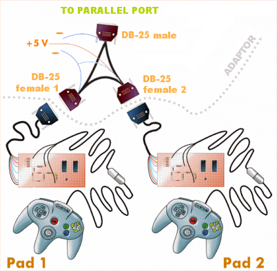

In order for both controllers to work, you must have
DirectPad Pro version 5. You must install 2 copies of DirectPad in Control
Panel/Game Controllers and assign each a different ID.
In conclusion, the entire setup with both pads, circuits and adapter cable would look like this:
If you want to use both pads in UltraHLE, you will need the latest
version of UltraHLP.
I hope that this webpage has been useful to you. I assure that it works, at the moment, it is in use
on my PC (I simultaneously have a PlayStation pad and a Nintendo 64 pad connected to two parallel ports).
