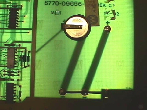

K... Let's get started by flipping the board over onto the solder side & heating up each terminal of the triple AA holder & flowing in some new solder to reactivate that old won't-even-melt-solder. Start over again with the first one you did & this time remove all the solder with a solder sucker. The tough one is usually the one that actually connects to the ground rail. If you have all the others free you can take a small screwdriver & insert it under the holder at the stuborn joint, heat & gently pry at the same time. It'll usually pop right out that way.
Next you'll want to Scotch-Brite those thru-hole pads so that your solder will adhere & to clear away any corrosion left on them. Do both sides. Now close in the bottom middle & upper right holes with solder as show in the pic above right with black circles.

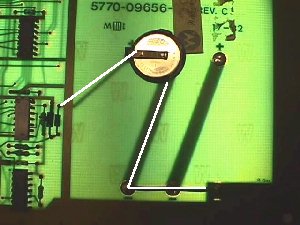

Take the 2" piece of wire, strip back approximately ¼" on either end & tin with solder. Bend the leads to 90 degree angles & drop it through the two lower outside holes as pic'd above... solder it in. Now drop the battery holder in from the top with the + terminal in the upper left hole & the - terminal in the upper middle hole. This is a perfect drop in alignment, so when you flip it over to solder it in you can lay the holder on your bench & the weight of the board will keep it in place while you solder it.
Slip the battery in with the + side up & clean up any mess you've made with solder on both sides of the board & you're good to go. The pic above right is taken on the light board & you can see the right end trace that we eliminated very clearly. It is just sitting there taking up real estate now. The jumper on the bottom gives us a new path to ground & the holders positve terminal connects right into the ram backup power circuitry. You can measure your voltage to see that everything is copacetic if you like. Measure from any logic ground to the blocking diode on the left... first component you see the trace going to above. You can follow along the path it takes, which is a long one, over to the cmos ram located in area of D1 or D2 grid on the board... near the CPU.

K... time for a quick review list for those who work better from them.
    1. Reflow old solder using new solder.
    2. Remove the existing battery holder.
    3. Fill in the lower middle hole with solder.
    4. Fill in the upper right hole with solder.
    5. Jumper the 2 lower outside holes with a 2" wire.
    6. Place the battery holder + terminal in the upper left hole
      (Closest to the center of the PCB & - will drop into place.)
    7. Add your CR2032 lithium battery.
    8. You're good to go, test if you like.
