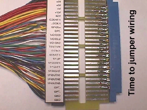

The pic's above are self-explanatory and are the first steps to getting this adaptor under way. In the pic at the left, you will note that the tip of the pliers is underneath the card to hold it level. You can see it better in the pic on the right which shows it after being tacked in place first before continuing to solder all connections..just in case you need a little adjustment. Be sure to tack both sides...one at each end & one in the middle.

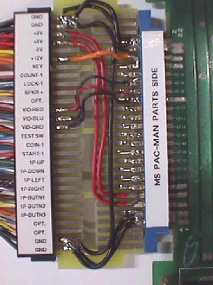

The foolproof way is to get an old labeled JAMMA connector & place it on the JAMMA side of the card, like in the pic to the left. Make sure that you have the parts side up for the Pac side & you'll need the pinouts for it, as well, but before you get started, you have to make two bridges on the adaptor card. One shorts out C-D-E on the parts side, and the other shorts out 3-4-5 on the solder side. It's easiest to count up from the bottom of the actual fingerboard to positions 6-7-8 on both sides. Perhaps the pic will be a more concise way to show it. As you see in the pic in the upper right, it is much easier to look at it than it is to describe it. Do the same on the flip side. Once this is done, you can run the power wires as below. I'll put pinouts to power wiring, but the rest will have to be done from a pinout sheet.
In the pic on the left you will see that the DC power lines are easiest to run first. On the parts side as depicted, there are 3 ground wires leaving
the Jamma pins 27/28 made into a single pad with 2 lines going to A/B on the Pac side, also padded to form a single pad, and the 3rd wire goes Jamma 1/2 which ties the 2 ground pads together & then it also has 2 grounds leaving the Jamma 1/2 to go to the Pac side pad of Y/Z. The 2 red 5 volt lines form a pad at the Pac side C/D/E & run up to the Jamma side 3/4 pad. Lastly, we have the 12 volt orange wire going from Jamma 6 to Pac W/X pad. I've found that even most techs stop at this point & figure that there is enough wired in for power needs....not true...much more is needed. As I said, you want more parallel lines in, the more streams you can put into the lake (PAC),the more you will lessen the resistance by dividing up the load going into the Pac board. This will make the job of your switcher very easy to do with no strain at all and providing ample power to drive the board. When finished, this also produces a side effect of reducing all the heat that eminates from the board itself, especially reducing heat off from the rams & proms which often times are hot enough to burn you.

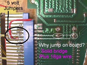

Lets power out the solder side now. In the pic to the left, you'll see what the solid jumpers & 18 gauge wire do at C-D-E & at 3-4-5...essentially the same thing you are doing by jumpering diodes on the Pac board itself, but
without harming the integrity of the board. Ok...the backside power wiring is a little different. Starting with the ground pad at Pac 1/2, the first wire goes to the Jamma pad e/f while the second wire goes to Jamma pad A/B.
The ground pad at Pac 21/22 also splits with one wire going to Jamma pad A/B while the second wire goes to Jamma pad e/f. A crisscross ground layout with all double connections made into a single pad. The 2 red 5 volt lines on Pac pad 3/4/5 run up to the Jamma pad C/D where there is also a 3rd red wire leaving this 5 volt pad & connecting to the Pac single pad at position 18.
All that is left for power now is the second 12 volt input which goes from Pac pad 19/20 to the Jamma single pad F.

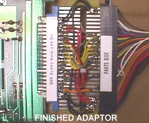

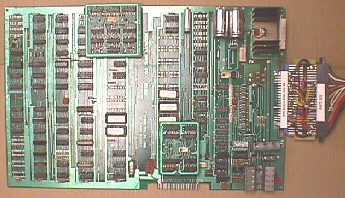

Well...filling in the rest of the wiring is fairly easy & straight forward & a 20 gauge wire should be ample for any remaining connections. After I finished this one I performed tests on it in 3 Jamma cabs with the same results in each one with different Jamma pcbs. The first test was with a Double Dribble whereby I set the power supply to deliver 5.00 volts to the edge connector. I then powered down & moved the Jamma harness to the Pac board & repowered & measured the voltage at the Pac edge connector. It measured 5.10 volts & the Pac played fine & ran cool. I repeated this with a Plotting & a Neo 1-slot with the exact same results. With the parallel system in use, I actually deliver more voltage to the Pac board than I do to the Jamma boards.
